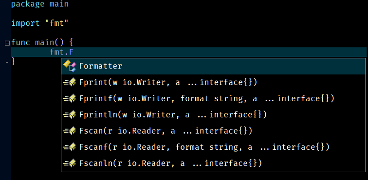

To test the configuration create a simple test.go file and fire off an auto-complete request:
lsp go
If the auto complete does not fire make sure the GOPATH is correctly configured and the test.go file folder location is in that path.
