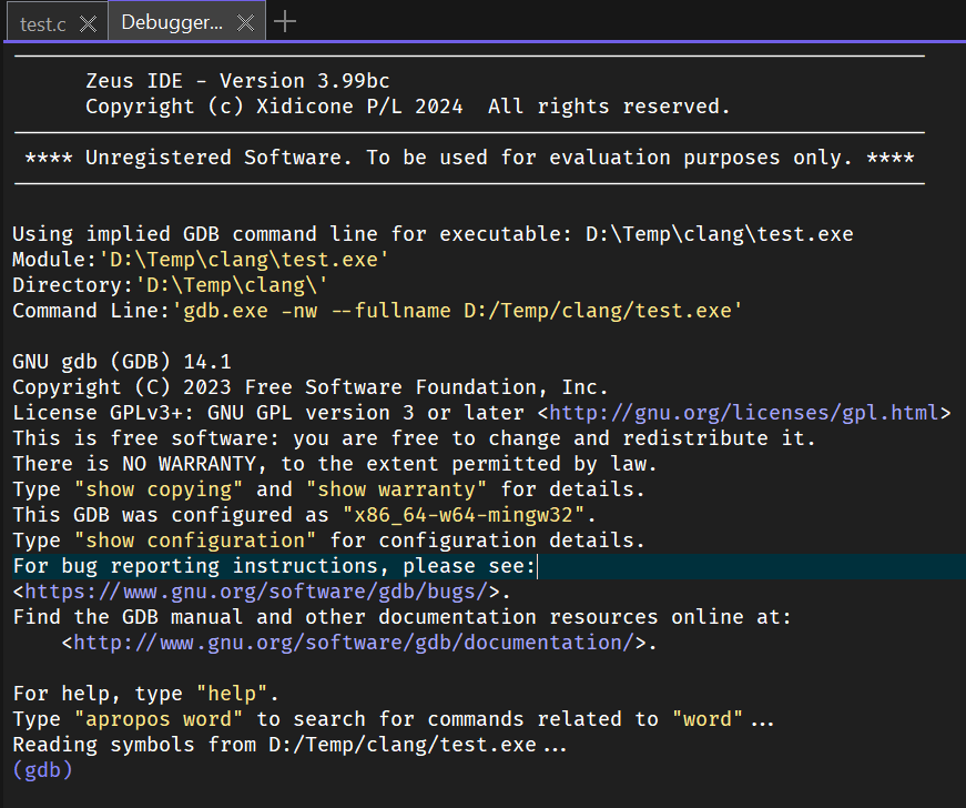

C Language Debugging Example
Consider the following test.c single file application:
#include <stdlib.h>
#include <stdio.h>
int main(int argc, char *argv[])
  printf("Hello world!\n");
  for (int i = 0; i < argc; ++i)
      printf("%d: => %s\n", i, argv[i]);
  return 0;
Assuming the GCC compiler has been installed, the compiler details found in the C/C++ Document Type need to be changed to be changed to be:
gcc -ggdb "$fn" -o "$fb".exe
With the test.c file active the Compiler, Compile menu will run this compiler command line:
gcc -ggdb test.c -o test.exe
That command line will produce a test.exe file containing DWARF symbolic information.
And with the test.c file active the Workspace, Debugger menu will run the GDB compiler for that test.exe file as shown below:

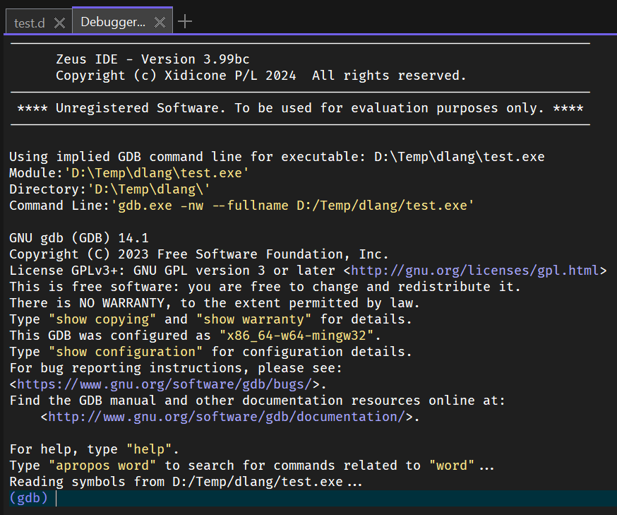

D Language Debugging Example
Consider the following test.d single file application:
import std.stdio;
void test(int index)
    writeln("Hello: ", index);
void main()
    writeln("Hello, World!");
    for (int i = 0; i < 10  ; ++i)
        test(i);
Assuming the LDC compiler has been installed, the compiler details found in the D Document Type need to be changed to be changed to be:
ldc2.exe -gdwarf "$fn"
With the test.d file active the Compiler, Compile menu will run this compiler command line:
ldc2.exe -gdwarf test.d
And with the test.d file active the Workspace, Debugger menu will run the GDB compiler for that test.exe file as shown below:
