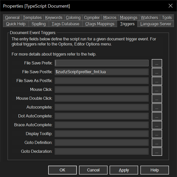

To make this happen, edit the document type and add the following line of code to the save and save as postfix triggers:
$zud\zScript\prettier_fmt.lua
Example: Setting up a Prettier TypeScript Trigger
For example, the image below shows how the Options, Document Types menu was used to edit the TypeScript Document Type and in the Triggers panel the Prettier command lines were added to those events as shown below:
With those triggers in place, the Zeus Prettier macro is triggered every time the file is saved and that will then run the following command line:
npx --quiet prettier --write --loglevel silent --no-config $fn
NOTE: The $fn in that command line is replaced with the name of the file being saved. To change this command line just edit the prettier_fmt.lua macro trigger and change it to suit.

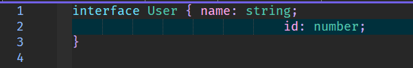

With the everything working as expected, and the following test.ts TypeScript file looking as follows:

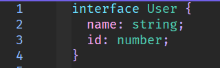

When this file is saved, it will be automatically reformatted by Prettier to look like this:
