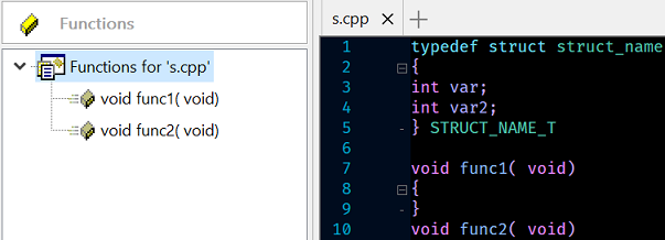

For a workspace containing your file this result is produced:

For your file used in this scenario the following results are produced:

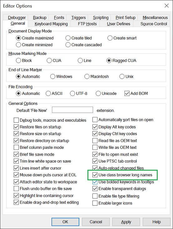

To make those results display as required you need to turn on the tag long name option which can be done by editing the general section of the editor options panel as shown below:

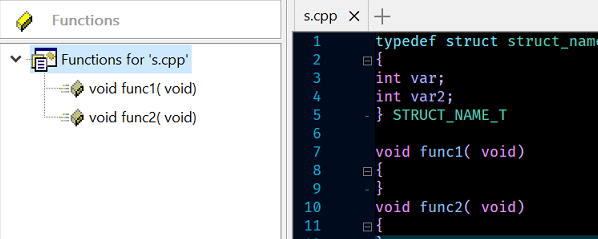

With that option enabled, the following results are produced for the Workspace Functions Panel mode:

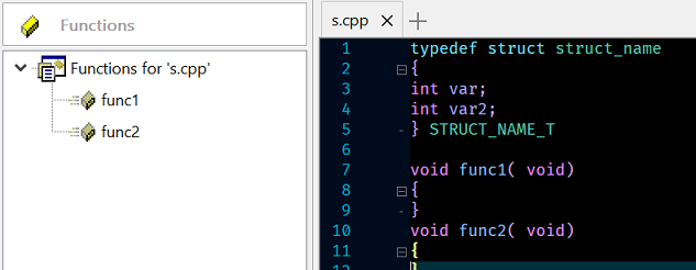

For me, running the FunctionFindAll function displays the correct results (i.e. file open and workspace open):
func1
func2

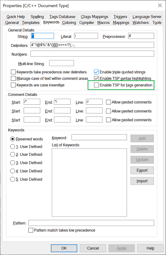

But I can replicate your issue by turning off the option shown below, doing a Tags Rebuild and then re-running the FunctionFindAll function:
That suggests to you me you have that option turned off, which means you are running the ctags program (i.e. xtags.exe) as the source of tag information.
If that is the case, this is an issue will be with the ctags program and one possible fix would be copying the xtags.exe from your old install and replacing the current xtags.exe file.
But a better option would be turning on the TSP tags options as the ctags option for tag information is a legacy feature.

When I 1st looked at my C++ keywords tab, both TSP boxes were unchecked and I have an entry for numbers. I made my dialog matched yours and rebuilt tags, but the problem persisted. Then I checked Enable TSP for tags generation and rebuilt tags. With it checked, both function displays are now correct. I know that is the opposite of what you said, but that is how it is working for me. Thanks for the help. I would have never thought to looks at these option, not knowing what TSP is.
That was my mistake as my post was not clear. I was showing that with this off, the problem is created.
The TSP is the Tree Sitter Parser. It is used for syntax highlighting and a replacement tag generator.
With this option off, Zeus uses the xtags.exe for tag information and hance the cause of the problem you reported is found in that xtags.exe component.
