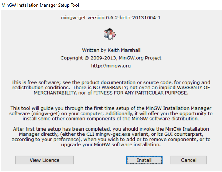

Step 1) Download the mingw-get-setup.exe file from the MinGW Setup Wizard page.
Step 2) Run that downloaded setup utility:
c:\temp\mingw-get-setup.exe
Step 3) This will bring up the installation wizard shown below:
Step 4) Walk through the steps of that setup wizard and when complete the MinGW Installer will have been installed and an icon to that program created on the desktop.

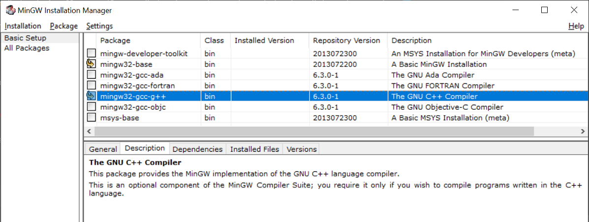

Running that installer will display the following screen:
a. Select the packages you wish to install by right clicking on the items to be installed.
b. To install the selected packages, use the Installation, Apply Changes menu and select the Apply option in the resulting dialog.
NOTE: At a minimum select the mingw32-base (C compiler) and mingw32-gcc-g++ (C++ compiler) package options or alternatively select all the packages as shown in the image above.

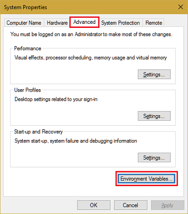

Step 3) Once the installation is complete use the Windows Control Panel to open up the System icon and use the Environment Variables button found in the Advanced system settings link to add this bin installation folder to the PATH environment variable.
IMPORTANT: Take care when editing this PATH environment variable. Only add to it. Never delete from it. More details about the PATH can be found here: http://www.zeusedit.com/phpBB3/viewtopic.php?f=5&t=6176
For the installation folder noted earlier, this bin folder will need to be added to the PATH:
C:\mingw32\bin
