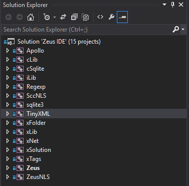

As a comparison consider the Zeus IDE software which is written in C/C++ using Visual Studio and is held in source control using Subversion and Agent SVN.
That Visual Studio solution is made up a dozen or so projects which in total consist of about 600-700 files and the entire solution is under source control.
1) Opening PowerBuilder for the first time results in check status of the whole folder the Target file is located. In our case there is 400-500 objects that are checked for no reason (Most are image files).
Opening that solution in Visual Studio happens in about 4-5 seconds and while that is happening I can see Agent SVN is being called to refresh the status.

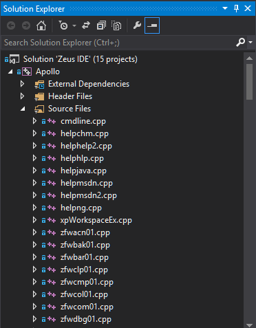

Visual Studio also has an option to do a full source control status refresh and that action takes about 9 seconds for that 600-700 file solution.
4) Expanding a PBL after PowerBuilder is idle past the "Status Refresh Rate" in the Workspace Properties.
If I expand one of the Visual Studio project nodes, for the first time it does result in about a half second delay.
Now I am not sure if is because of Agent SVN or Visual Studio but it is still only half a second and only for the first expansion.
When expanding the PBL it refreshes all objects in the PBL as expected but once that finishes an hourglass shows and it appears to refresh status on everything in the Target folder.

There are no issues in Visual Studio (Our VS projects are much much smaller though) so lets not compare apples to oranges.
The size of the project might be an issues but as I pointed out I have a 700+ file Visual Studio project and I see very little slow down.
