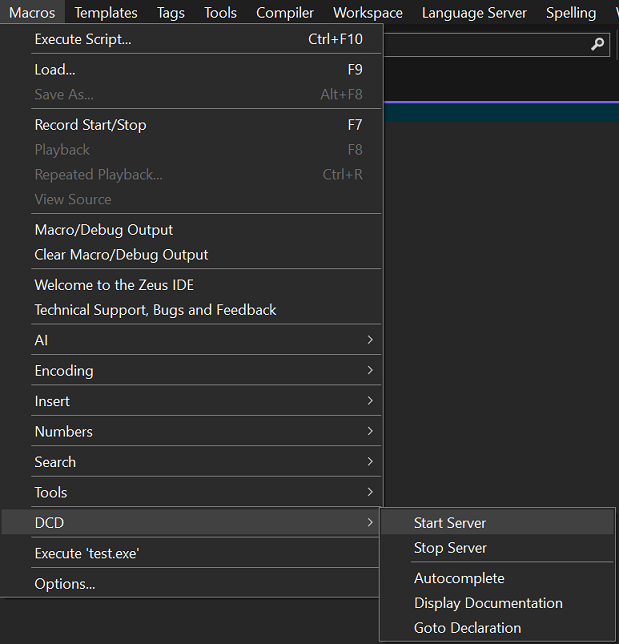

Manually Starting/Stopping the DCD Server
For the autocomplete to work the DCD server first needs to be started, using the Macros menu shown below:
NOTE: That menu will only show if a D file is being edited.
