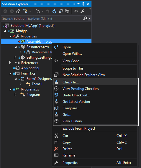

Step 5: Using the Source Control Inside Visual Studio
At this stage, the solution has been imported into the repository and the solution has been bound to the repository.
To check the solution is correctly bound use the View History menu on any of the files in the solution and the history dialog should be displayed as shown below:
vs_history
With the solution now fully configured, use the check out, check in, revert, compare or any of the other source control commands to manage the files in the solution.
To access the source control from inside Visual Studio use the popup menu as shown below:
vc_use
