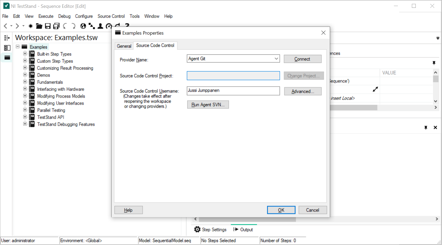

Inside TestStand with a workspace open, right click on the workspace and select the Properties menu to edit the workspace properties.
Change to the Source Code Control panel and select the Agent Git as the active provider as shown below:
Use the Run Agent Git button to bring up the Agent Git configuration utility to do the once off configuration of the plug-in as shown below:

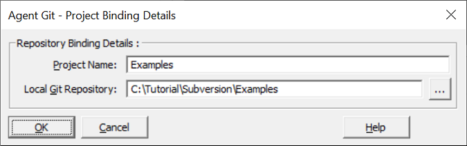

That will bring up the binding dialog as shown below:
Accepting that binding dialog will then prompt with the following response.
Answer yes to have the project added to the source control.

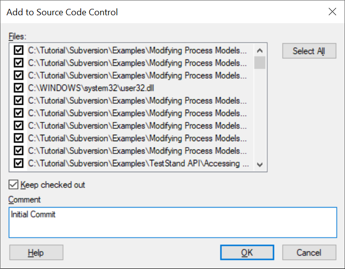

The final step of the check-in process is the Add to Source Code Control dialog shown below:
Add a check-in comment and complete the check-in by hiting the Ok button.

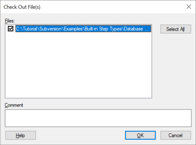

For example, using the check-out option from that menu will display the check-out dialog shown below:
