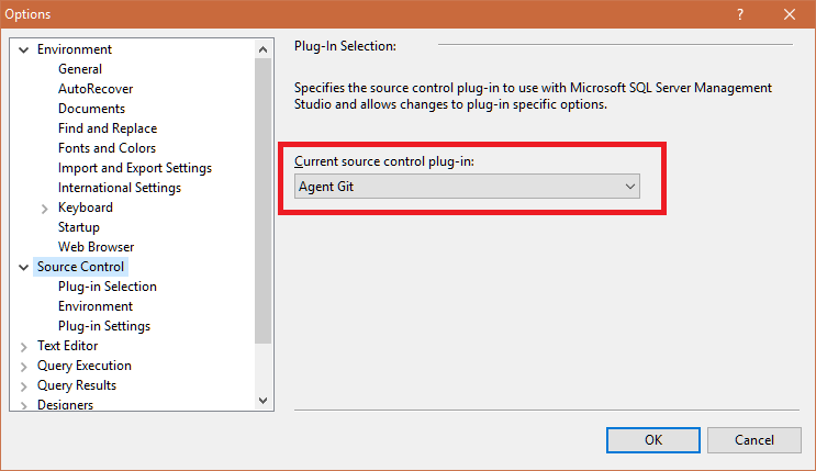

Step 1: Agent Git Provider Setup
From within the Microsoft SQL Server Management Studio IDE use the Tools, Options menu to bring up the Options dialog and in the Source Control section select Agent Git as the active provider as shown below:
Git Repository Details

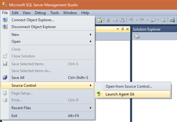

Step 2: Configure Agent Git
Bring up the Agent Git configuration as shown below:
