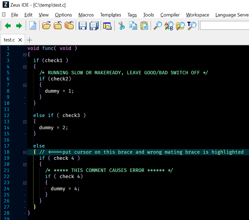

Starting with your code from the forum post, I used the Macros, Tools, Re-indent and Restyle menu option to produce this formatted version of that code:
void func( void )
  if (check1 )
    /* RUNNING SLOW OR MAKEREADY, LEAVE GOOD/BAD SWITCH OFF */
    if (check2)
      dummy = 1;
  else if ( check3 )
    dummy = 2;
  else
  { // <====put cursor on this brace and wrong mating brace is highlighted
    if ( check 4 )
      /* ***** THIS COMMENT CAUSES ERROR ****** */
      if ( check 4)
        dummy = 4;
As you can see when I place the cursor on the brace in question, I get the following brace matching result:
I'm guessing you're not seeing that same result as for me the brace matching looks correct.
I guessing this error relates to one of your options that got erroneously applied when you copied over your old zConfig options.
To find the option that is wrong I would do the following:
1. Install the latest version in a new directory. Zeus can run any number of versions side by side, the just have to be in their own directory.
2. From the command line run the old and the new versions by using the -s option (run a second instance option)
3. Confirm there is a difference in the brace matching in both of these versions.
4. Visually compare the settings found in the C/C++ Document Types to find the difference.
