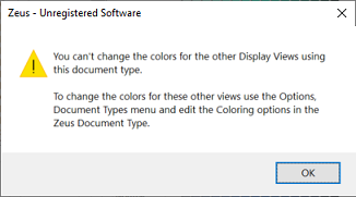

I am using Zeus(x64)-Version 3.99a-Beta5. Here's the error. I believe I did what this error says but can't get it to work.
Zeus (x64)
You can't change the colors for the other Display Views using this document type.
To change the colors for these other views use the Options, Document Types menu and edit the Coloring options in the Zeus Document Type.
OK

It sounds like the error you are seeing is the one shown below:
This message is actually a new message box and it is there because if it allowed you to change the tool, compiler and project colors they would not have any effect, hence the reason that action is blocked.
As the message says, to change the tool, compiler and project colors you need to edit the Zeus Document Type.
Now you can use the Options Document Types menu to do this, but an easier way would be as follows:

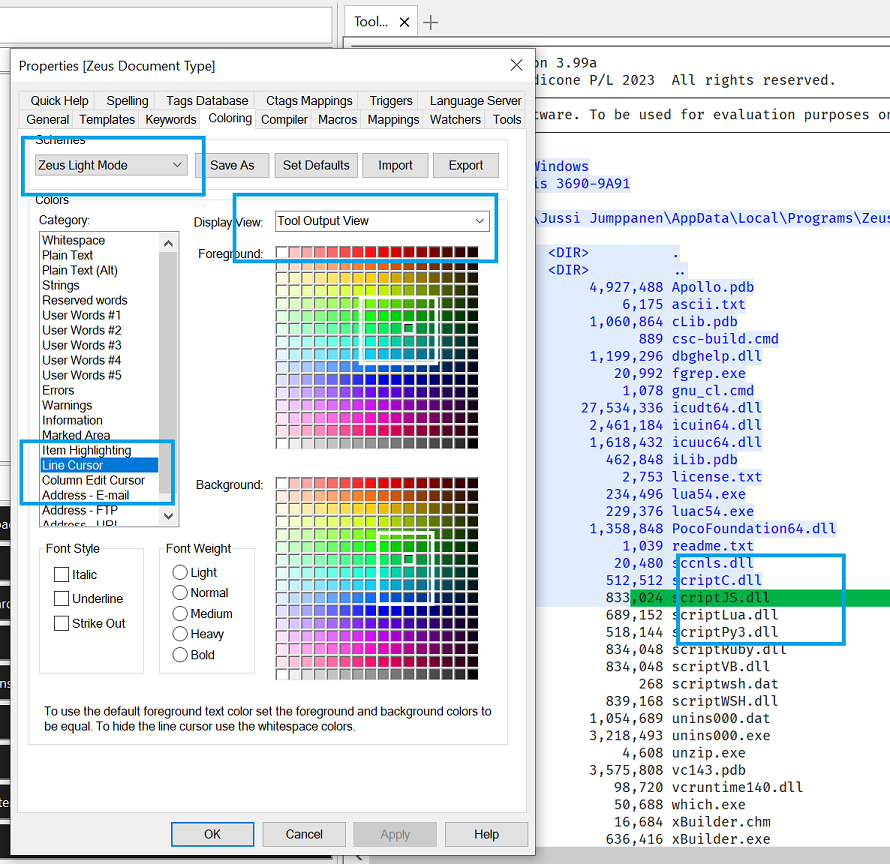

Re: tool window color cant be changed
As a test I made a change to the tool line cursor to create a green cursor, using the dir command approach that I mention before.
The image below shows the results: If you look at the white and blue rectangles in that image you can see the settings that I need to select, in order to make this change and you can also see the resulting green line cursor.
NOTE: In my case the tool window is using the Zeus Light Mode document type, only because I've previously used the Options, Color Schemes, Set Light Mode menu to change the editor to light mode.
If you have not used that menu then the tools will be configured to use the Zeus Document type instead.
My Zeus doesn't behave as you illustrate. Under Schemes in the color tag, mine says Default Colors. I change it to Zeus Light Mode but I still get the error dialog attempting to change the Display View. I then exited the dialog and selected Option menu, Color Scheme menu item. In the menu, there is a check mark next to white. I click on Zeus Lite Mode but nothing happens. The check mark stays on White.
I think you said in my mode, the tools window will follow the document options. When I change these the color for Zeus document, I see no change on the screen in the tools or build windows.
I just mention again that 3 - 4 weeks ago when I 1st upgraded Zeus, this tool window color updating worked fine. I've done a few beta updates and one release update since then. After each update, I copy my old config folder to the new install. Any chance this is a bug in the new software where an old config option is corrupting the newest software?

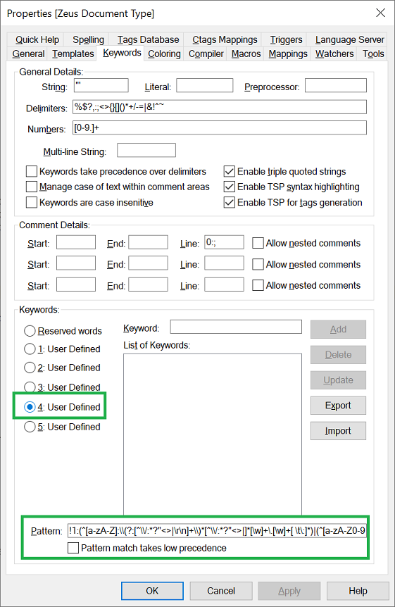

These tool output details are identified by the patterns regular expressions defined in the Keywords section.
For the file name information, the pattern shown below identifies these output details: As you can see from the image, this pattern is defined in the User Defined 4 and that corresponds to the color setting used to color this pattern.
