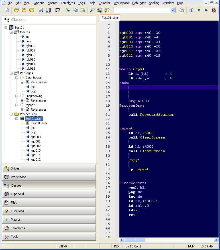

Re: Setup Z80 language
Thank you Jussi, that worked!
However, a few issues I don't understand how to fix: the macro lookup does not work, and "inc" and "pop" are showing up as macros:
I did everything as described, the label's "ClearScreen, ProgramOrg, repeat" appear in the Packages section, which is as expected I think, however in the Macros section we have "inc, pop" and all the constants, but not the Copy1 macro.
I have attached a screenshot that shows how it looks like and the example asm file.
Would be cool if you have a solution for that.
Thank you
PS: please don't wonder that I'm using the ampersand to prefix hex numbers
Thank you

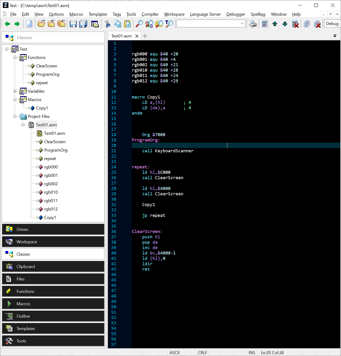

Looking into this there are at least two issues at play:
1. The default ctags automatically parse ASM files and this is why many of these additional tags are being created.
2. The .ctags details used were copied from the web and they don't appear to be well defined. The new .ctags details shown below work much better and this definition also fixes the first issue as it disable the built in ASM parsing.
Here are the new .ctags settings:
With these setting in place these are the results produced:

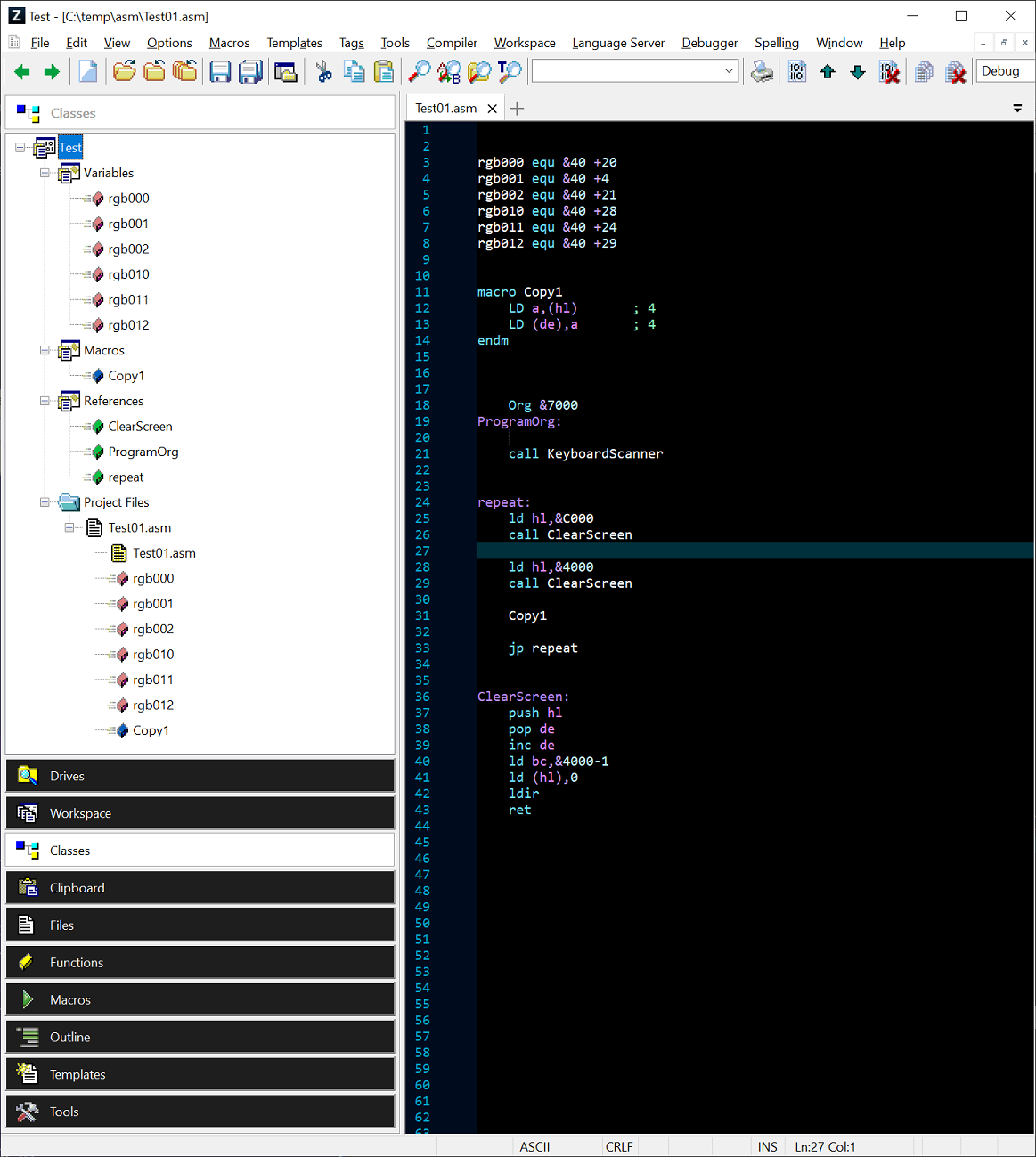

NOTE: To have those labels show up as functions use this .ctags configuration instead:
That will then create the following tag information:

--langdef=z80
--langmap=z80:.asm
--languages=-Asm
--regex-z80=/^([a-zA-Z]+[a-zA-Z0-9_]*):/\1/r,label/
--regex-z80=/^macro[ ]+([a-zA-Z]+[a-zA-Z0-9_]*)/\1/m,macro/
--regex-z80=/^([a-zA-Z]+[a-zA-Z0-9_]*)[ ]+equ[ ]+/\1/v,variable/
--langdef=z80
--langmap=z80:.asm
--languages=-Asm
--regex-z80=/^([a-zA-Z]+[a-zA-Z0-9_]*):/\1/f,function/
