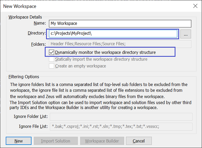

Upon creation of a new file, is there a way that it can get added to the workspace automatically? I saw the Help file for the function "FileAddToWorkspace" but was unable to find an example for it. I saw the option to add the current file to active project but it doesn't show up in the workspace navigator. Any hints would be helpful.
Re: Adding a file to workspace automatically
If you are running the latest version of Zeus you can create a new workspace (using the Workspace, New menu) that is dynamic as shown below:
When that dynamic option is used any file or folder created or deleted from the workspace directory or any sub-directory will be automatically reflected in the workspace structure.

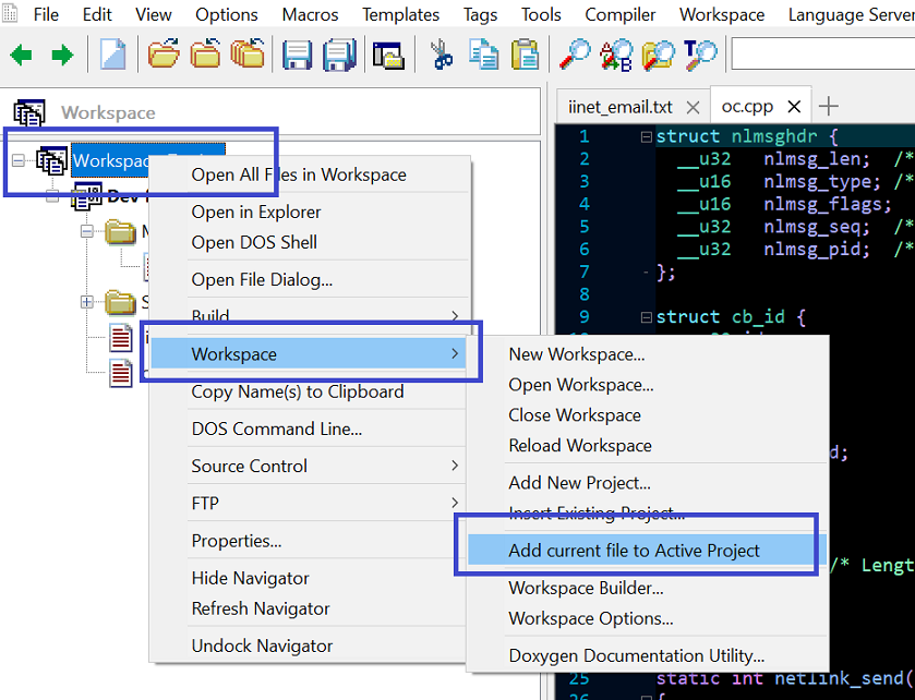

I just noticed the second part of your question:
Are you referring to the option shown in the image below :?:
I ran a test using that option and for me it worked as expected, adding the current file to the active project with the result file showing up in the navigator tree.
The only thing you do need to be careful off is if you use this option to add files to a workspace that has been defined as dynamic.
That will not work as expected only because the next time the project is refreshed (which is done automatically) the project tree will lose all those manual additions.
For a dynamic workspace the file needs to added to the disk itself and then it will get added automatically to the navigator structure.
