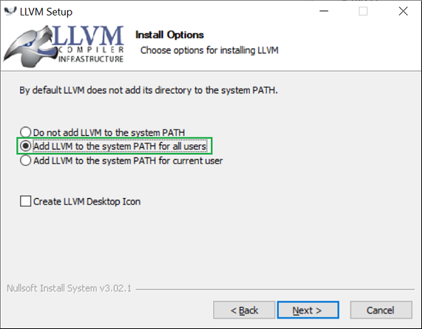

1. Download and install the Windows pre-built binary installer from this page: https://releases.llvm.org/download.html
2. If the installer asks for admin rights, select the PATH for all users option otherwise the installer will only adjust the PATH for the admin user and not the current user.
Alternative if you use the Do not add option.. option you will need to add the installation folder to the PATH after running the install.
To add adjust the PATH manually follow the instructions found here: viewtopic.php?t=6176
The folder that needs to be added to the PATH is as follows:
C:\Program Files\LLVM\bin
