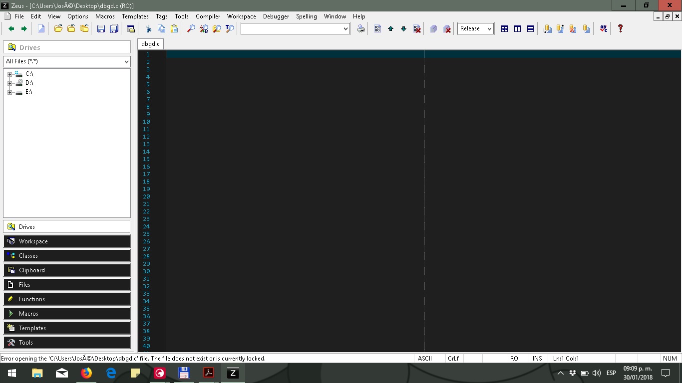

Zeus can't show the content of a file when I open it from menu left-button mouse, the file appear empty on Zeus IDE and show the message "Error opening the 'C:\User\Jos.." File. The file does not exist or is currently locked. I think that Zeus have some problem with special characters, because in the message the folder name is incorrect, the right name is C:\User\José not C:\User\Jos©.
I use Windows 10, Zeus IDE 3.98l.
I add image from my desktop.
Thank you in advance.

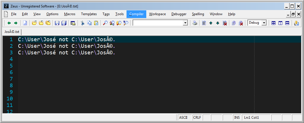

As a simple test I used the text of the file name in you post to create a test file but for me that test file loaded just fine:

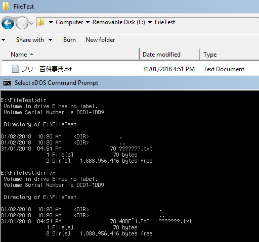

You should see a similar issue if opened a command prompt and ran a dir in that folder:
The only way to fix this would be to change Zeus from being an ANSI executable into being a Unicode executable, however making that change would require some fairly large changes to the Zeus code base, meaning at this time there is no fix for this issue

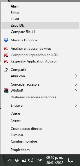

, sorry but I didn't specify the mouse menu, the menu that I refered is the windows system menu that appear when you right-click on a file (I add a image). I think that in this case the issue is related with unicode parameter pass to zeus.exe, I mean:
If you create a file in C:\ with the name "dumpe.c" and another with "dumpé.c" and you try to open the first one with Zeus like this C:\Program Files (x86)\Zeus>zeus C:\dumpe.c you can see that all is ok, but when you try to open the another one with C:\Program Files (x86)\Zeus>zeus C:\dumpé.c you can see that the file is empty and in the lower side appear the message "Error opening the 'C:\dumpé.c' ...".
