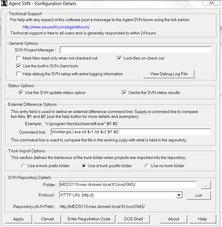

3. Configured AgentSVN (AgentSvnConfig.png)

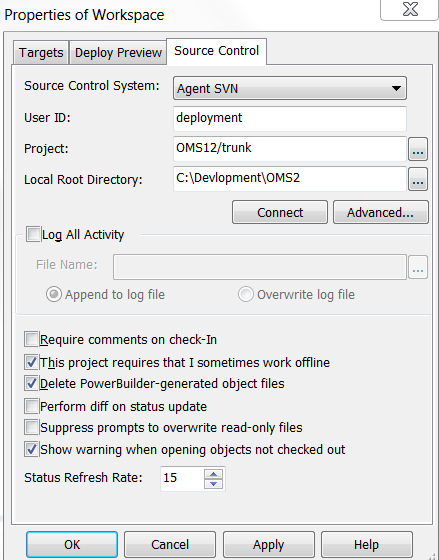

4. Configured PB Source (see attached file PBConfig.png).

6. When I set up one of development m/c with similar settings, it keeps on showing refresh icon each time I click pbls. When I click on show difference, it says source copy is same so my question is why it's showing the refresh icon.
7. It's tremendously slow when switching to pbls or check-out/in.

The first thing you need to ensure is you are running the latest version as shown in the About box.
The latest version of Agent SVN is 2.55 and can be found here: http://www.zeusedit.com/agent/download.html
You can create a log file as follows:
1. Make sure PowerBuilder is not running.
2. Deleted the Agent SVN log file found here:
NOTE: The <User ID> above represents your user ID.
3. Use the Windows Start Button, All Programs, Agent SVN, Agent SVN Configuration to start the utility program.
4. Turn on the Help debug the SVN setup... option.
5. Start PowerBuilder and replicate the issue.
6. Send through the resulting log file as an e-mail attachment.
That version has a new debug feature that measures the duration of commands.
Turn on the timing option using the same steps as above.
Also there are several threads on this forum specific to PowerBuilder so I would also read those. Just search for PowerBuilder.
Finally from this PowerBuilder thread: viewtopic.php?f=11&t=7551
The user reported improved performance by making the PowerBuilder refresh rate 600.
