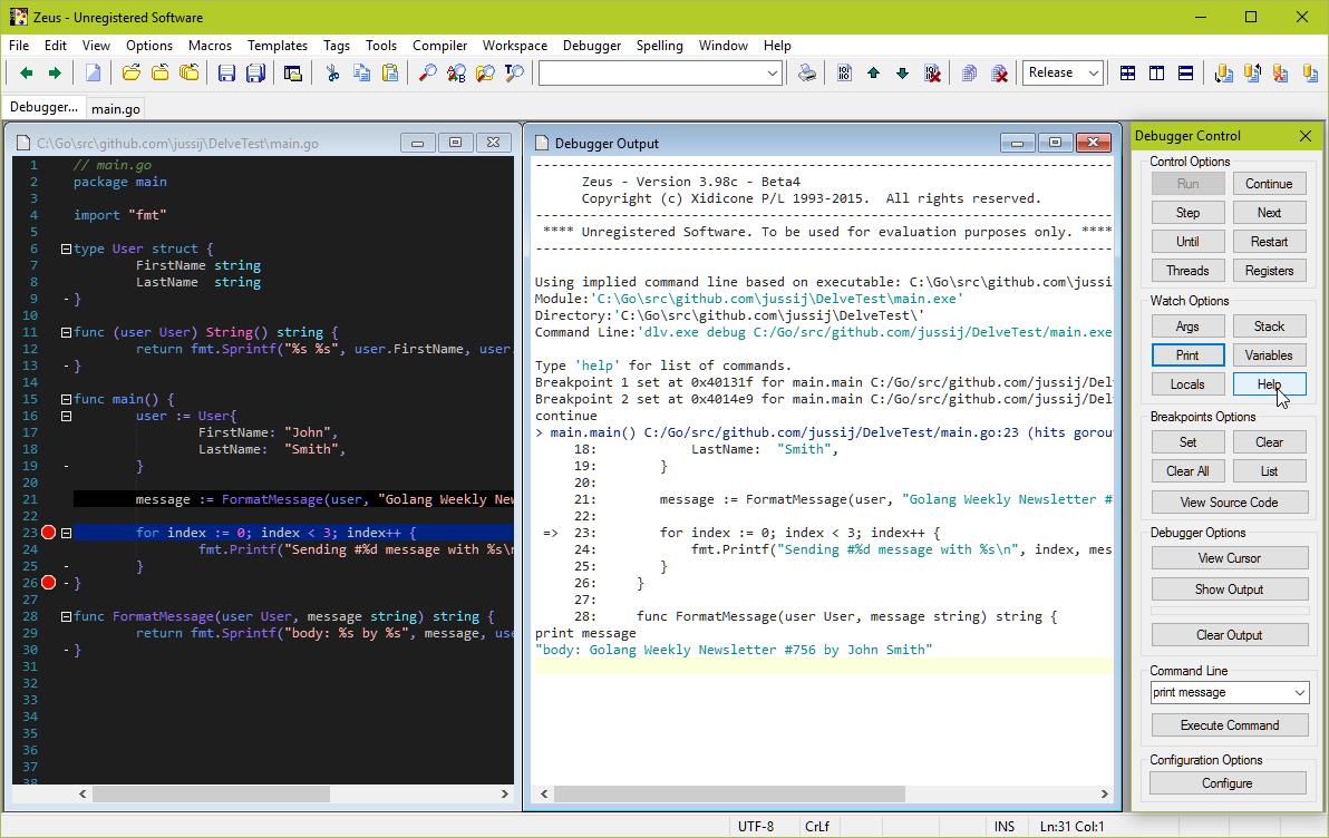

Delve and Zeus in Action
With that latest version installed you can debug Go code inside the IDE as shown below:
