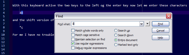

For me I have no trouble searching for any of those characters as shown by the image below:

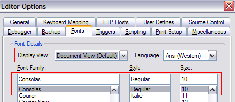

These are the font settings that I have configured:
