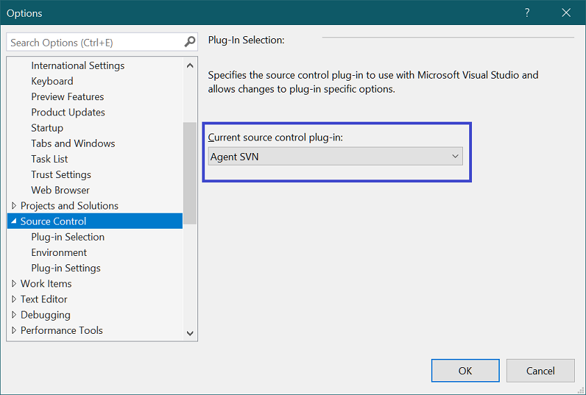

I did some testing of Agent SVN using the Microsoft Visual Studio Community 2019 edition and that version of the IDE still list Agent SVN in the Visual Studio Tools, Source Control panel:
I continued that testing to see if MSVS 2019 still worked with Agent SVN and from what I could tell it worked just fine.
So it appears that MSVS 2019 does in fact still support for MS-SCCI :)
