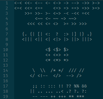

To better understand what this means consider the following code:
With Zeus configured to use the FiraCode font and with the ligature font option disabled that code will looks like this:

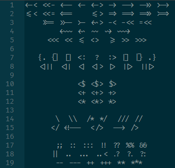

However, with the ligature font option enabled that code now looks like this:

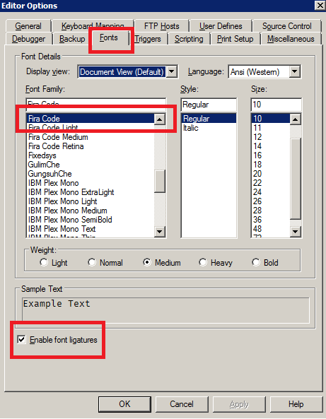

To enable this option use the Enable font ligatures option found in the Options, Editor Options menu, Fonts panel as shown below:
