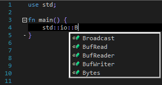

Code Complete
Consider this example code (where the '|' represent the cursor):
use std;
fn main() {
    std::io::B|
Using the Macros tab found on the Navigator panel and running the Racer - Autocomplete macro will result in this popup display:
That auto complete would also automatically fire in this situation, after typing in the ':' character:
fn main() {
    std::io::|
