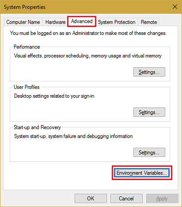

Step 3) Once the install is complete use the Windows Control Panel to open up the System icon and use the Environment button found in the Advanced settings to add the bin install folder from the previous step to the PATH environment variable.
IMPORTANT: Take extreme care when editing this PATH environment variable. Only add to it. Never delete from it.
More details about the PATH can be found here: viewtopic.php?f=5&t=6176
