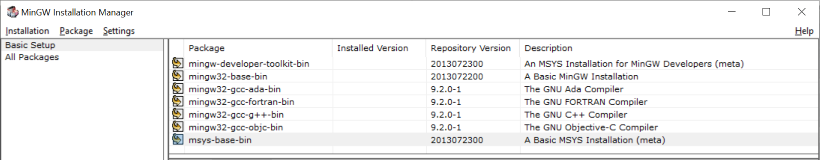

This will bring up the minimal Web installer that will bring up an install wizard to guide you through the installation process as shown below:
To install the software do the following:
a. Select the packages you wish to install by right clicking on the items to be installed.
b. To install the selected packages, use the Installation, Apply Changes menu and select the Apply option in the resulting dialog.
NOTE: At a minimum select the mingw32-base (C compiler) and mingw32-gcc-g++ (C++ compiler) package options or alternatively select all the packages as shown in the image above.

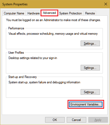

Step 3) Once the installation is complete use the Windows Control Panel to open up the System icon and use the Environment Variables button found in the Advanced system settings link to add this bin installation folder to the PATH environment variable.
IMPORTANT: Take extreme care when editing this PATH environment variable. Only add to it. Never delete from it. More details about the PATH can be found here: http://www.zeusedit.com/phpBB3/viewtopic.php?f=5&t=6176
