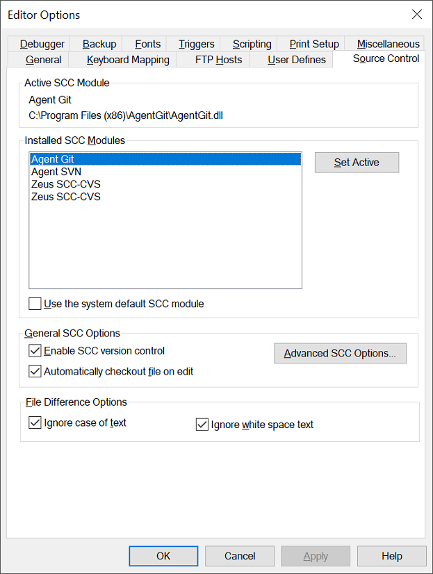

2. Start Zeus and using the Options, Editor Options menu select the Source Control panel and make agent Git the Active Source Control as shown below:

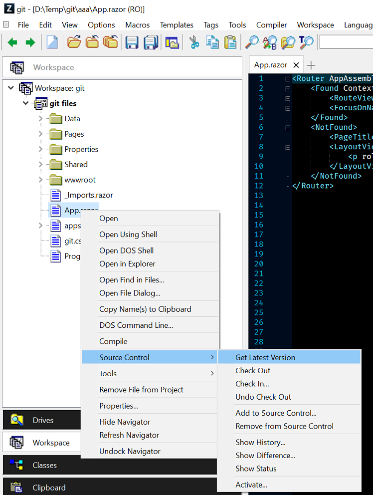

3. Create a Zeus workspace and then use the Add to Source Control menu to add the items of the workspace to the source control as shown below:
4. At this point the workspace has been bound to Git and the source control menus work as expected:
