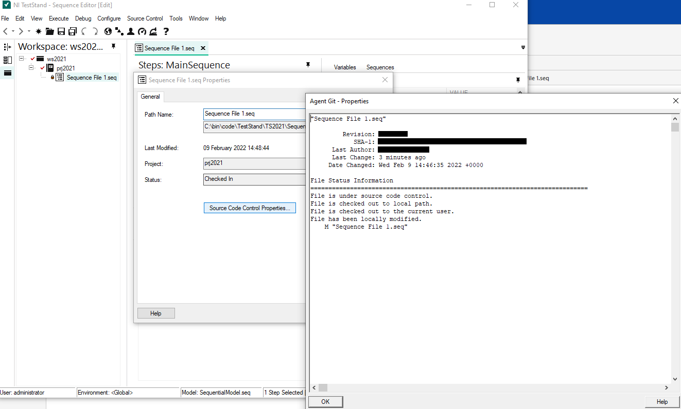

I am trying to use AgentGit to provide SCC integration with NI TestStand 2021, but am having a problem with the Sequence files not being registered by TestStand as being checked out. The Workspace and Project files check in and out ok, but not the sequence files (.SEQ).
Note the padlock on the .SEQ and the ticks on the Workspace and Project files.

Hi Ready,
Could you do the following:
1. Start the Agent Git Configuration dialog using desktop short-cut
2. Check the Help debug Git setup with extra logging information option
3. Click on the View Debug Log File button and take note of the file location in the file that is displayed. Also empty the log file.
4. Start The TestStand application and replicate the issue.
5. Once you replicate the issue send that log file to us as a zip file attachment. Use the info @ zeusedit.com e-mail address.
With that information we should be able to figure out what is going wrong.

Re: AgentGIT and NI TestStand CheckOut problem
This issue is now fixed in the latest version of Agent Git.
