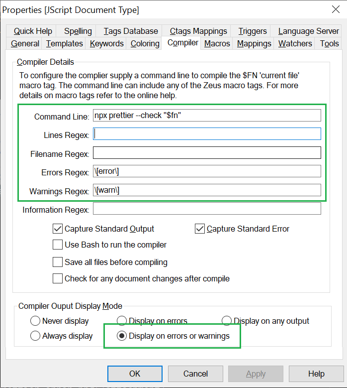

Start Zeus and use the Options, Document Types menu to edit the JScript Document Type.
In the Compiler panel enter the following details:
   Command Line: npx prettier --check "$fn"
  Errors Regex: \[error\]
Warnings Regex: \[warn\]
(o) Display on errors and warnings
Those settings should look like the screen shown below:

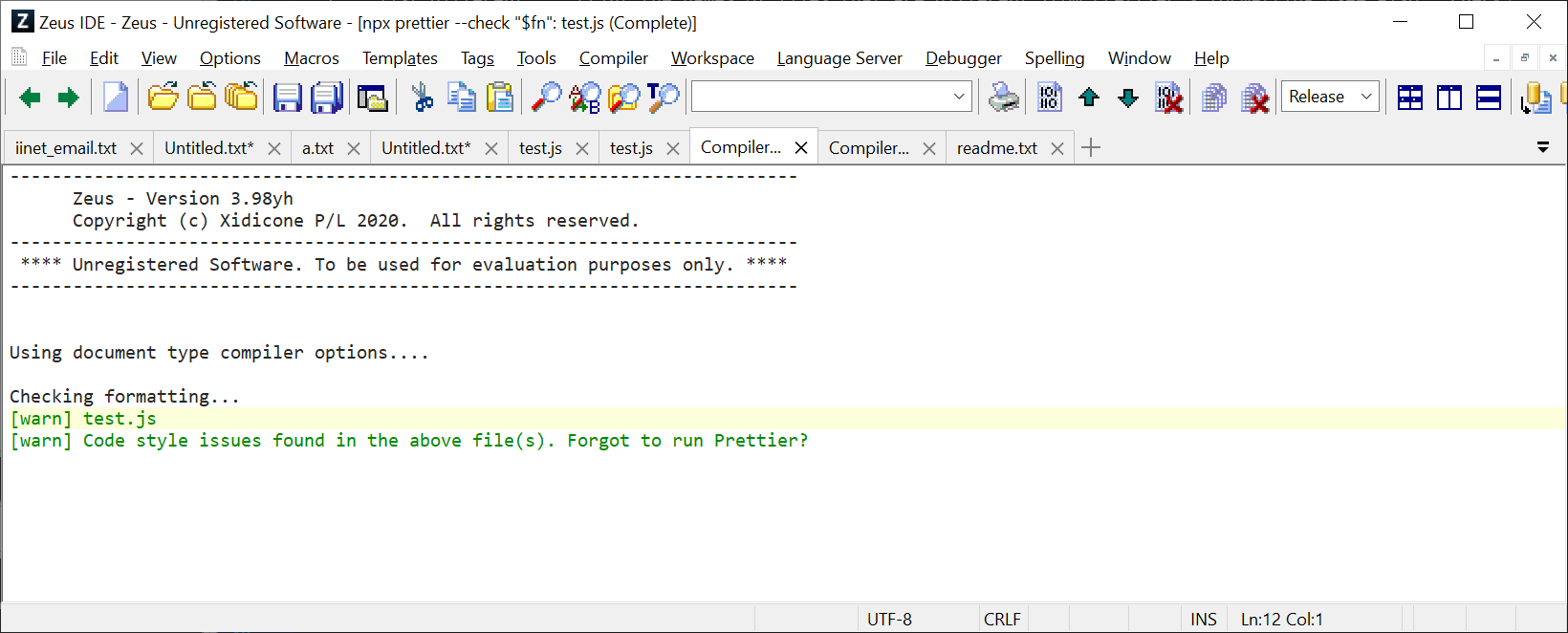

Now with test.js as the active file use the Compiler, Compile menu to run the linter.
That should result in the output shown below:
