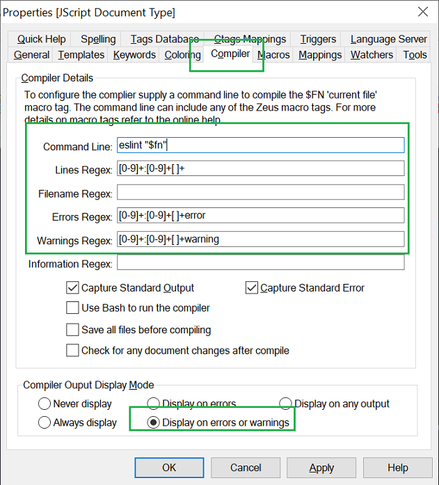

Using Eslint inside Zeus
Start Zeus and use the Options, Document Types menu to edit the JScript Document Type.
In the Compiler panel enter the following details:
   Command Line: cmd.exe /c eslint --no-eslintrc "$fn"
   Lines Regex: [0-9]+:[0-9]+[ ]+
  Errors Regex: [0-9]+:[0-9]+[ ]+error
Warnings Regex: [0-9]+:[0-9]+[ ]+warning
[attachment=1]eslint-comp.png[/attachment]
[x] Capture Standard Output    		[x] Capture Standard Error
(o) Display on errors and warnings
Those settings should look like the screen shown below:

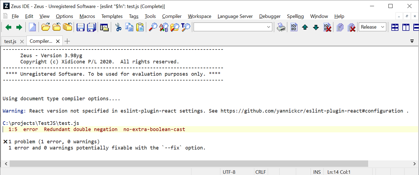

In the project folder initialized earlier, create a test.js file shown below:
if (!!(typeof window === 'undefined')) {
  console.log('Hello from Node.js!');
Now with test.js as the active file use the Compiler, Compile menu to run the linter.
That should result in the output shown below:
Clicking on the error should then navigate you back to the line and column where the error is found.
