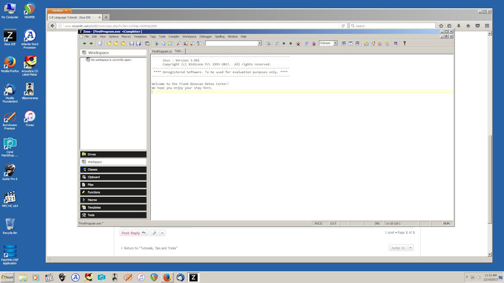

Okay I got the C# Tools and Compiler installed and added to my Path. I wrote some simple code inside Zeus and it compiled fine. My question is do I have any options in controllling the output window?
Currently as you will see in the screenshot I uploaded there is the copyright information and other stuff like version information etc. at the top of the output window and then after that I see the actual output from my program.
Is there a way to clean up the output window so only the output from my program shows?

Re: Can you do C# Programming without using Visual Studio?
The only way to control this is via the scripting layer using the scripting functions shown below:
int file_open_tool(string file name [,string caption] [,add_copyright = 1])
int file_open_project(string file name [,string caption] [,add_copyright = 1])
int file_open_compiler(string file name [,string caption] [,string source file], [add_copyright = 1])
These functions will load a file into a new windows and they have the option to not include the copyright banner.
So to do this you would need write a new macro that runs the executable, captures the output to file and then loads the output using one of the functions above.
However, that approach will run into issues if you ever run and executable that you expects users input :!:
FYI currently executables are run using the macro below and it also does handle the case where the executable expects user input:
$zud\zScript\run_exec.lua
To open that file in Zeus paste that line into a new Zeus document, select the line and then use the and then use the View, Open File menu.
