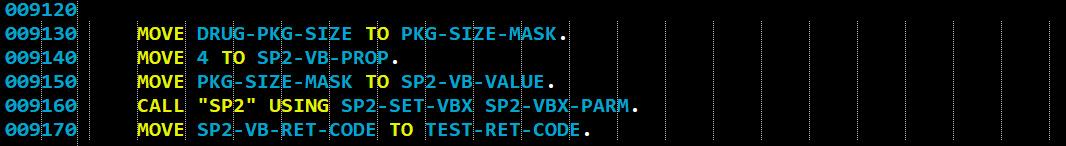

That didn't work. I am aware of the White Space option and use it occasionally.
What I am referring to is that it is displaying a vertical line at every tab stop. In my case, every 4 spaces.
See the picture below
Re: Stop tab stops from displaying
Those vertical lines look like the line indentation markers.
Those are controlled at a per document type level so with the file active use the Options, Properties menu and in the General section turn off the Display line indents option.

Perfect, thank you!
