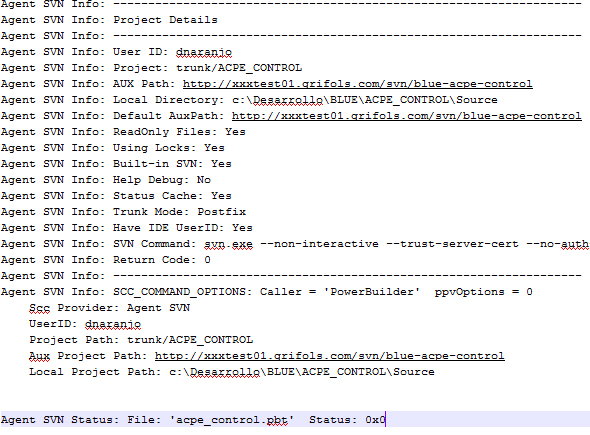

The tests I've done well apparently until Refresh Status. When we try to Refresh Status from a pbl we get this message ''
Agent SVN Status: File: 'acpe_control.pbt' Status: 0x0
The contained objects of pbl aren't connected to SVN. We can't see the SVN menu in PB.

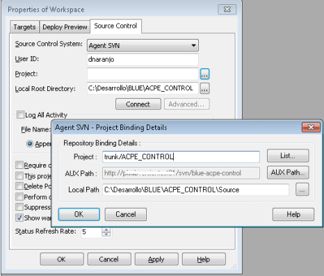

When I configure the work path in the configuration plugin, we see the following message:
To continue this operation there needs to be a valid SVN working copy at folder location specified above an that folder doesn't contain a working copy.
If I try to get the working copy with TortoiseSVN I get the same result.
Then I change the Local Path to C \Desarrollo,BLUE,ACPE_CONTROL,Source and I get the log result.
See the logstatus -Logstatus.jpg Attachment-

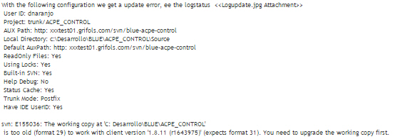

With the following configuration we get a update error, ee the logstatus -Logupdate.jpg Attachment-
Is it possible that last version of Agent SVN isn't good to svn1.7.20? What's the good version?

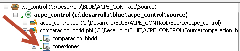

I was able to eliminate .pbg synchronize files to the re-created and then the status works ok.
When performing the checkout, PB close and reopen the workspace, then the PBL is outside the Source Control I can not go to checkin. This is a big error for us.

- Objects without status after reboot
- withoutStatus.jpg (45.71 KiB) Viewed 29020 times

Edit: While what I stated above is correct I then had a look at the image of the error message that you received.
In one of the images that you posted it says: The working copy at '.....' is too old to work with the client 1.8.11
What that means is the client that comes with Agent SVN is to new to work with your older SVN server.
So to fix this just start the Agent SVN Configuration utility and deselect the Use the built-in SVN client tools option.
This will mean that Agent SVN will use whatever client you have defined in the system PATH environment variable.
So naturally make sure you older client is defined in the PATH.
