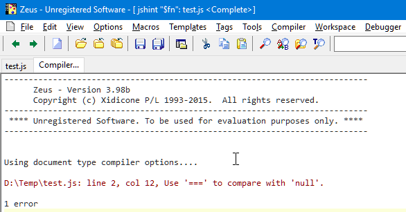

That is all that is required as per the configuration. To check that everything is working run the following test.
1. Create a test.js file containing the following code:
function main(a, b) {
  return a == null;
2. With the test.js file as the active document use the Zeus Compiler, Compile menu to syntax check the file.
This should result in the following error output being displayed:
Click on the error shown above and you will be returned to the line at fault in the test.js file.
