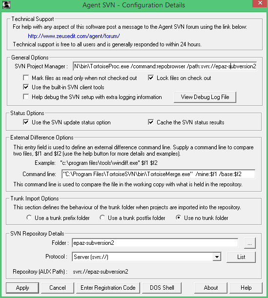

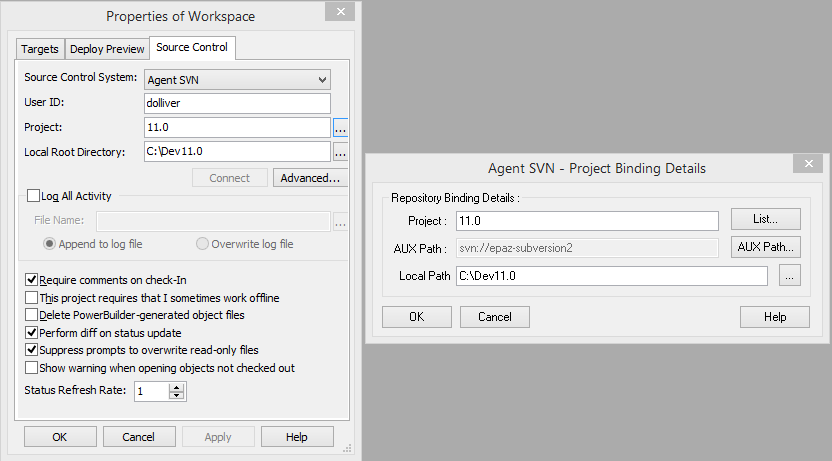

Attached are screenshots of Agent's configuration and its binding to PB. Any suggestions?

Do the status icons display correctly when the cache is turned off
In other words does this look like a issue with the cache option

Could you turn on the debug option inside the Agent SVN Configuration utility, repeat the example above and send me the resulting log file.
You can locate the log file using the button found in the configuration dialog.
